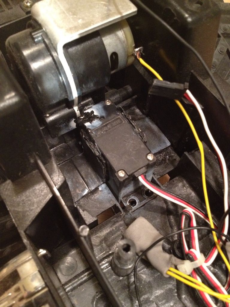

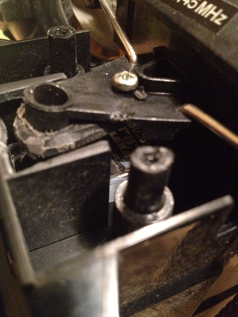

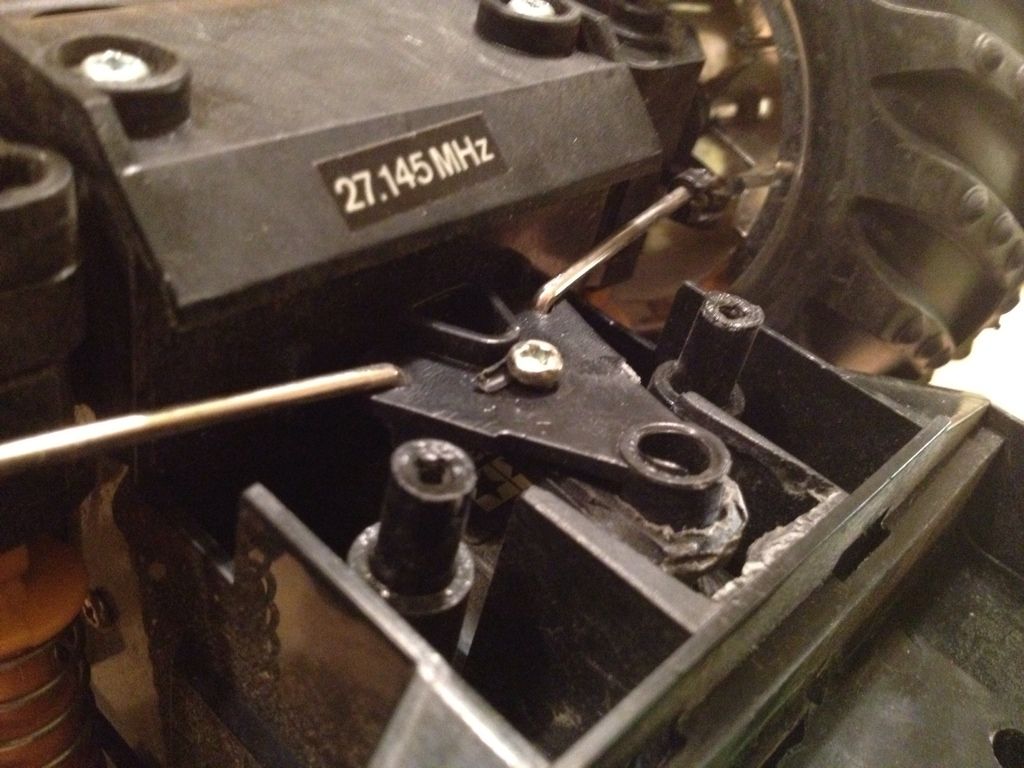

« Reply #8 on: August 09, 2012, 20:31:30 »
Here are some pictures of the servo setup on the 4wd version, they mount the same except 2wd is easier because it doesnt have the gearbox cuting it close.
