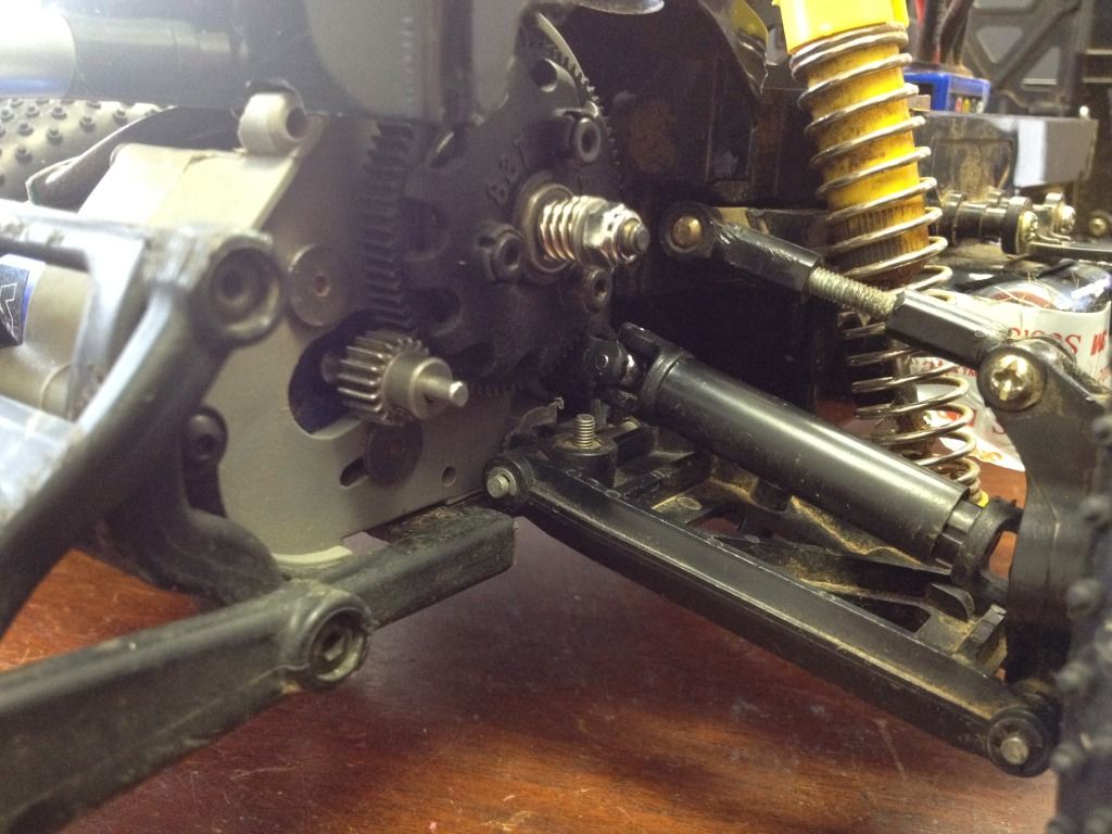

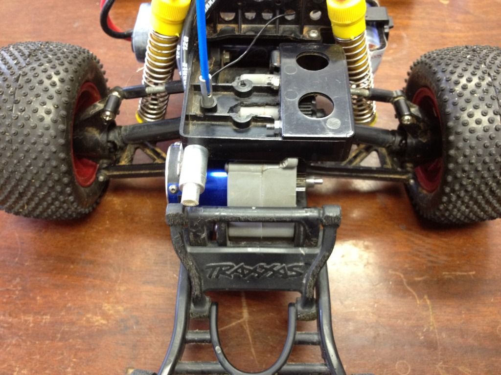

I have spent the last 5 years beefing up the stock transmission in this truck trying to make it hold brushless power, I even went as far as to machine out the diff housing. Well I got sick of replacing parts over the years and decided to swap out a Traxxas full steel VXL transmission. It took a bit of work to get it to fit and work right but it is by far the best mod I have done to it.
Now.......
It uses traxxas driveshafts(had to modify the hubs).
Can handle all the power I wanna throw at it.
But best of all, it looks bone stock.

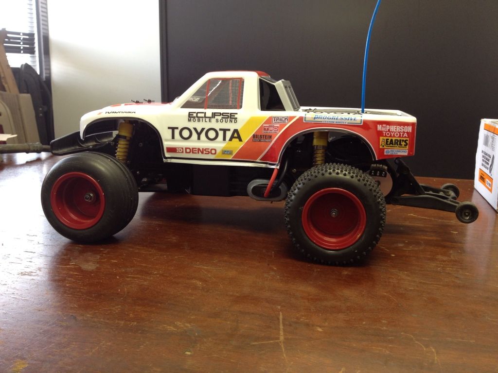

This truck is now 23 years old but runs like a bat out of hell. Using the same motor, speed control, transmission etc on my stampede I can get 74mph w/11.1v lipo on radar using a brick to keep the front end down. This chassis is lighter and has much better weight balance and center of gravity so I think 85mph shouldnt be a problem just I wont be using the body it took 2 days to paint to try it out.

Yeah they all had weak plastic gears. I tried and tried to keep the factory trans and i even went as far as to maching out a diff housing out of 6061 aluminum. the biggest problem was the brushless motor chatters on take off and actually chips teeth off the gears. It even broke the bracket 3 times that holds the idler gear in place.

Sweet looking king cab, I see you swapped out control arms and hubs too. Are those SEE's wheels and dirt paws? Im actually goin to be painting another king cab body tonight. Heres a few different king cab variation I have:

Yes they are Sees with some worn Dirt Paws. I did use traxxas a-arms, but I shorthened them to keep the same width as stock Tamiya.

Yeah i opened the stock hubs to fit the traxxas axles. Ive got mine setup with a 5400mah 11.1v mounted under the front body mounts and under full throttle it keeps the front end down very well. Its soo nice not having to worry about breaking gears anymore.
