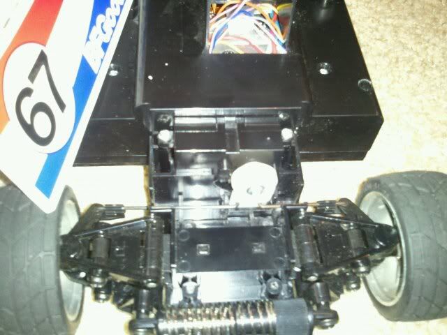

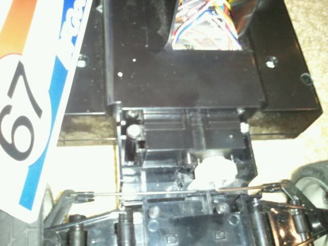

« Reply #7 on: April 06, 2011, 11:13:53 »
some pics of the servo setup

give the servo wires a little tug on both ends from board and from servo. But not to hard you dont wanna break them. just make sure there tight and while your tugging turn the radio to see if the servo will do anything.
We do this when we check electrical systems in old skool vehicles. if the wire snaps easy then its fualty and prolly whats giving it a short.
I tried finding one on craigs but no luck.  also find the crystal receiver on the car poke at it and turn the radio to see if the wheels turn

« Reply #13 on: April 18, 2011, 05:00:41 »
