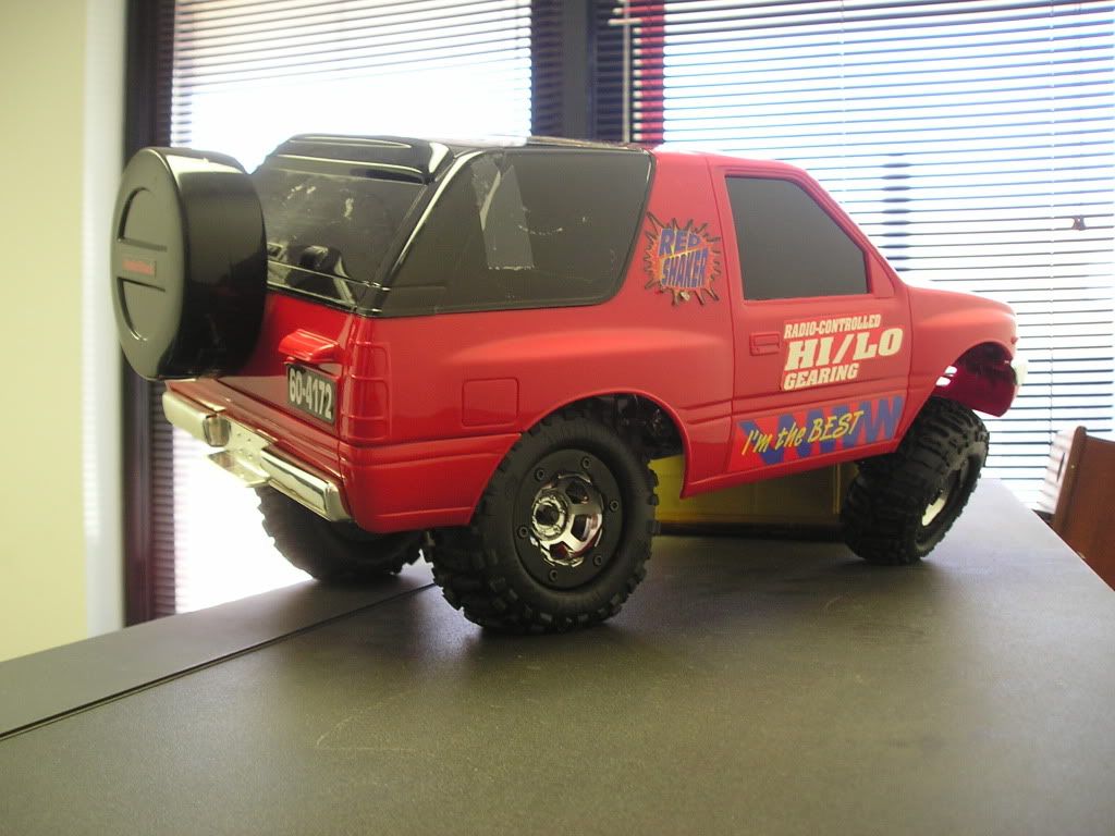

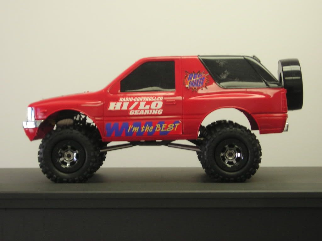

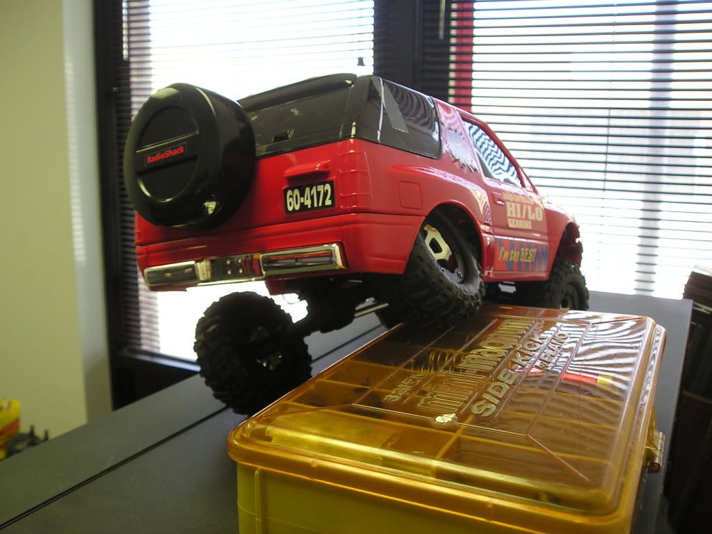

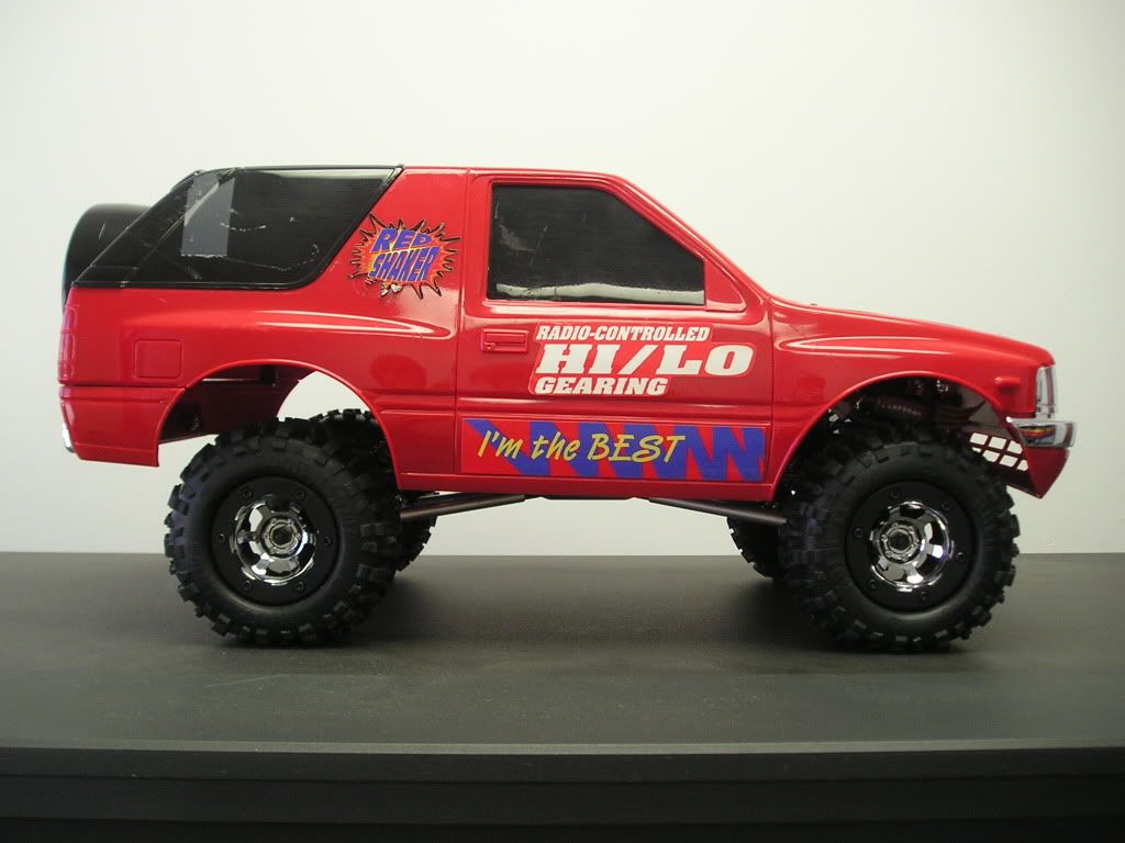

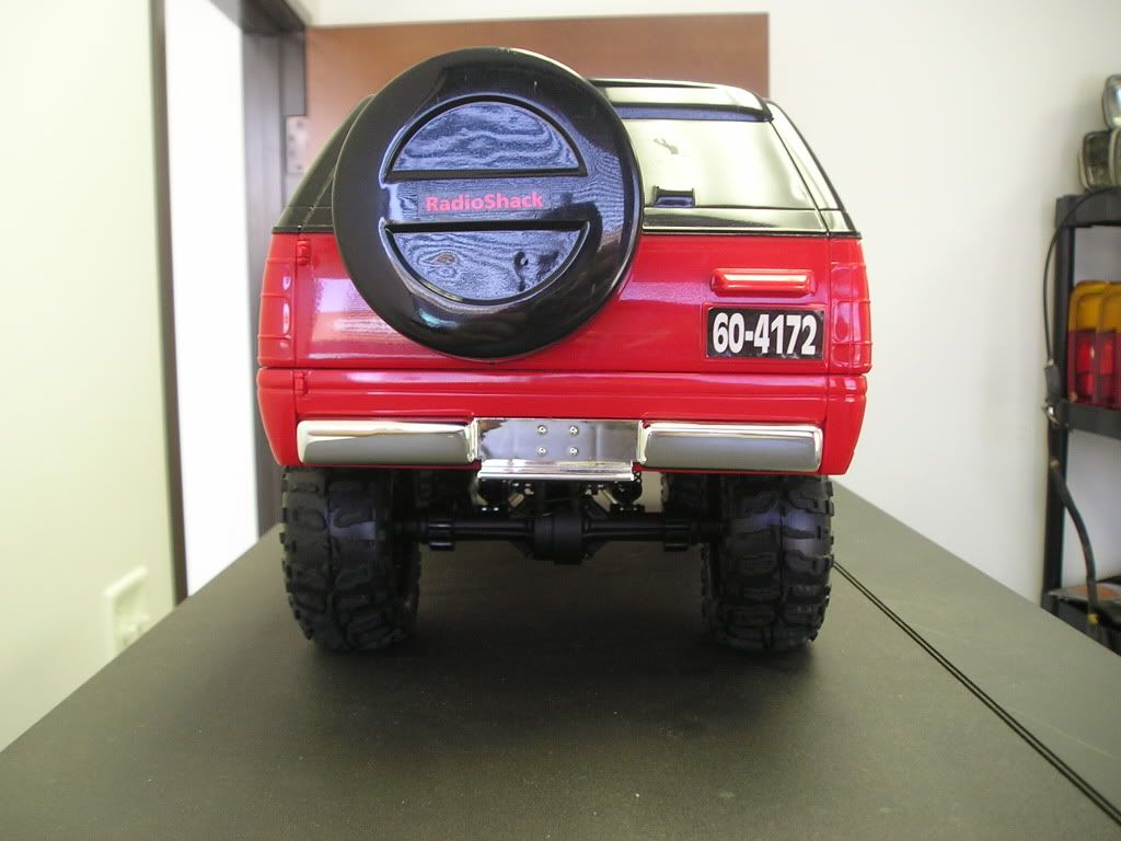

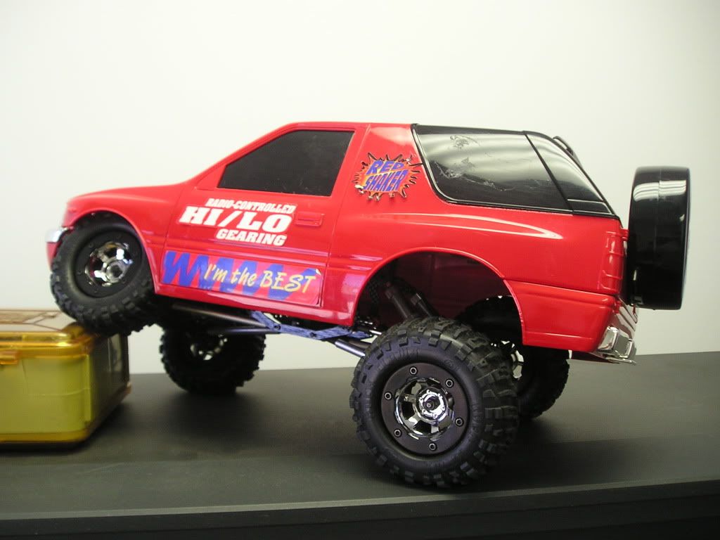

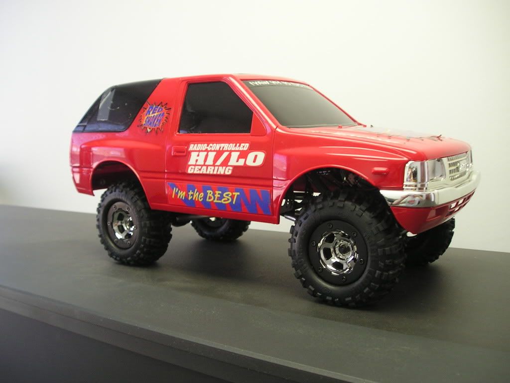

I just got done finally building the Scale Isuzu Amigo to make it resemble a real truck but yet fully capable off-road. Heres how I did it:
Losi Mini Rock Crawler Competition Chassis:
Stretched using ESP long wheelbase  lower links-deleted the 8 rod end nuts to shorten wheelbase to spec
Factory lower links mounted up top
ESP 1" drive shaft extensions-cut factory drive shafts shorter to fit
Electronics:
Mamba Micro Pro speed control
Losi 370 insane motor
Airtronics hi-torque mini servo
Losi 1650 mah 7.4v li-po
Airtronics FM reciever
Body:
I mounted the body using a bit of creativity and to make it clean without body posts I used velcro to mount it and it works great

That looks cool. Nice Crawler.
Re: Scale Isuzu Amigo with 6" lift and 35's
« Reply #2 on: July 19, 2011, 16:42:56 »
Thats pretty sweet dude good job on that
« Reply #3 on: August 09, 2011, 19:18:10 »
Nice work. I like the hard body and scale look.
rodncathstewart
  • Posts: 23
« Reply #4 on: August 12, 2011, 17:08:42 »
that's well cool and very scale looking. i drive an amigo with body lift mud tyres etc . now i want one of them to sit on the dash lol.
