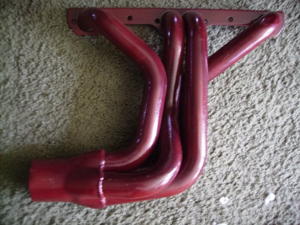

« Reply #2 on: March 07, 2011, 19:50:56 »
These are hedman headers drag series.
They are coated with Flame Tuff Flame Proof paint (2500 F%) and High temp heat paint (1500).
 I give 3 months before this paint starts chipping..
I would perfer to use these on my truck since my truck will some day be red when ever i buy paint.
 But they might go on here.
I've been having issues mounting these on my truck,
 there 3 inch ports with no flange. my exhaust i got for the truck are 2.25 daul flow with cross over pipes with flowmasters.
  I can weld a flange on and go from there but then there goes the paint lol.  Either way if i put it on the trans am i would use the blue flameproof caoting.

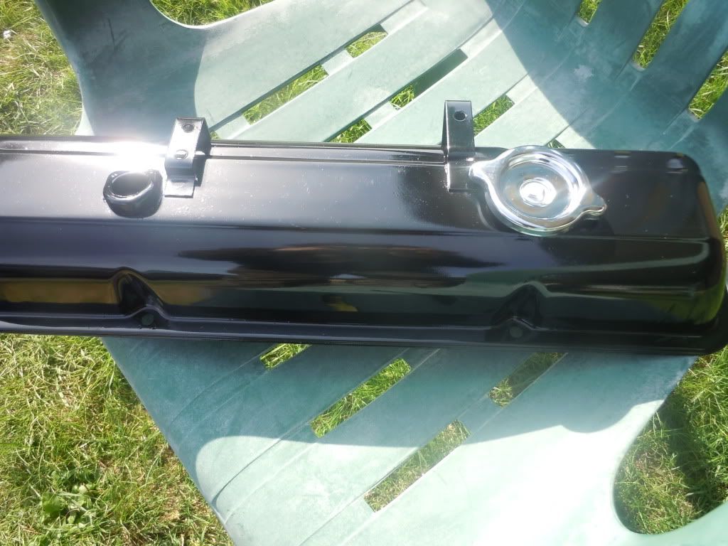

I painted these valve covers last night and baked them in my oven lol is that wrong?
Any way they came out ok but I should not have rushed the prep work

« Reply #4 on: October 29, 2011, 05:16:54 »
Hey, I bake polymer clay in my oven... I'm pretty sure cancer is a myth, just like global warmimg.   ;)
If you're going to be doing a lot of that though, I would recommend making a simple curing oven out of a plywood crate lined with heavy duty foil and powered by a few heat lamps and a rheostat.   Just make sure you operate it out in the open, away from your flamables.
