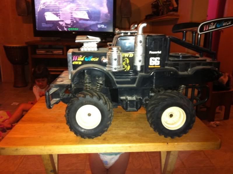

Diggin around in the attic at my folks and found my most favorite childhood thing ever:
I talked to my dad and he said that I stopped playing with it bc the remote broke. I've looked on eBay and have googled my tail off and haven't found much.  I'm guessing it wasnt a very popular model.
What are my options on getting a remote that will work? Iirc it was a pistol grip remote. The sticker on the bottom that would possibly show the freq is scratched to all heck. It still has the original 7.2v battery in it. I would appreciate any guidance in this matter.

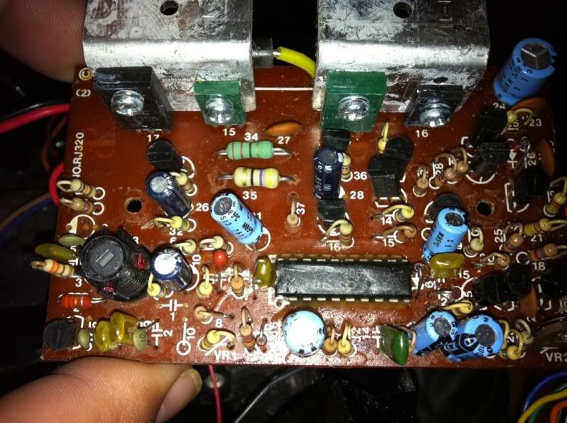

first thing you need to do is find out what brand it is if you dont know already, theyre all either 27 or 49 mhz, but different brands  use a different band, so tyco maybee 27.125 while nikko maybee 27.155 close enuff to interfere with each other at times but not enuff to actually  work with it. what id do is pull the body off and the radio cover and see if you see any name brand type stuff in there, like radio shack r/cs if you take the cover off and look at the board you would see that the workings is from a nikko r/c and pretty much interchange with each other, if you can recall what type functions this had will help too, was it simple funtion f/r and l/r or did it also have a turbo function where you pul the trigger a little more to get more power on the remote? or was it a digital proportional remote, if its a old nikko radio shack deal then it could have had it but since you say it had a pistol type remote it was probaly not a digital proportional.
o
Re: New to the forum need help
« Reply #2 on: December 13, 2010, 00:43:13 »
sorry ran out of room, as i was saying.....you dont have to find the actual remote that came with this, just one that has the same functions and frequency, so your best bet is once you have the frequency number if you can find it is to get on ebay and type in for example nikko radio control and usually you will find a long list of remotes you can buy, you could even buy both frequencies if you cant find yours anywhere on the truck, you may even get lucky trying some old nikko remotes because nikko changed there frequencies ever so often like say 27.135 to 27.125 so even if one doesnt work the next one might, also some of the nikko and radio shack remotes have an interchangeable crystal on the remote itself where you can buy different crystals to plug in to change frequency, ive seen remotes on ebay like this with 5-6 dif crystals included that you can change out. lastly if all else fails, find a donor 7.2v r/c truck on ebay for cheap and swap the electronics out and use its board.

i looks kinda like the Mad rat that i think scorcher has. but the mad rat is tyco but it also looks like these
radio shack wild ranger--
http://cgi.ebay.com/ws/eBayISAPI.dll?ViewItem&item=270674287867&ssPageName=STRK:MEWAX:IT
radio shack wild runner II--
http://cgi.ebay.com/ws/eBayISAPI.dll?ViewItem&item=300501475144&ssPageName=STRK:MEWAX:IT
« Reply #4 on: December 13, 2010, 12:58:16 »
ye it looks like the mad rat but looks more like 1 of my new buys more tho /turbo sound racer\

Yah, sorry I jumped the gun and forgot to tell you what I had. ITs definately radio shack/Nikko. I can't really remember the functions, I would like to say it had something where you pulled the trigger a little further it was supposed to go faster, but I'm not sure. It's a "Wild Horse" I also know they had a smaller one called the "wild pony" bc a friend of mine had that one. I pulled the body and looked at the board. I have to go to work now  and can post pics when I get back so you guys can give me a better idea of what I'm working with. My dad said he went to a hobby shop asking about it once and they were rude and pretty much gave him no help. I appreciate the replies.

High/Low switch
Where do I look for freq????
Long black piece def has "Nikko" on it. Battery and cover say Radio shack. Radio shack is even molded into the plastic somewhere.

did it look like this?
http://cgi.ebay.com/27-MHz-Nikko-Full-Function-Remote-FCC-ID-HS42SQPT-11-/270637084119?pt=Radio_Control_Vehicles&hash=item3f033a2dd7
heres the other 49mh
http://cgi.ebay.com/49-MHz-Nikko-Full-Function-Remote-FCC-ID-HS42SQPT-11H-/270637085467?pt=Radio_Control_Vehicles&hash=item3f033a331b
just by your description it seams one of these would be about right, at that cost you could buy both at once or throw the dice and see if ya get lucky and buy the right one
