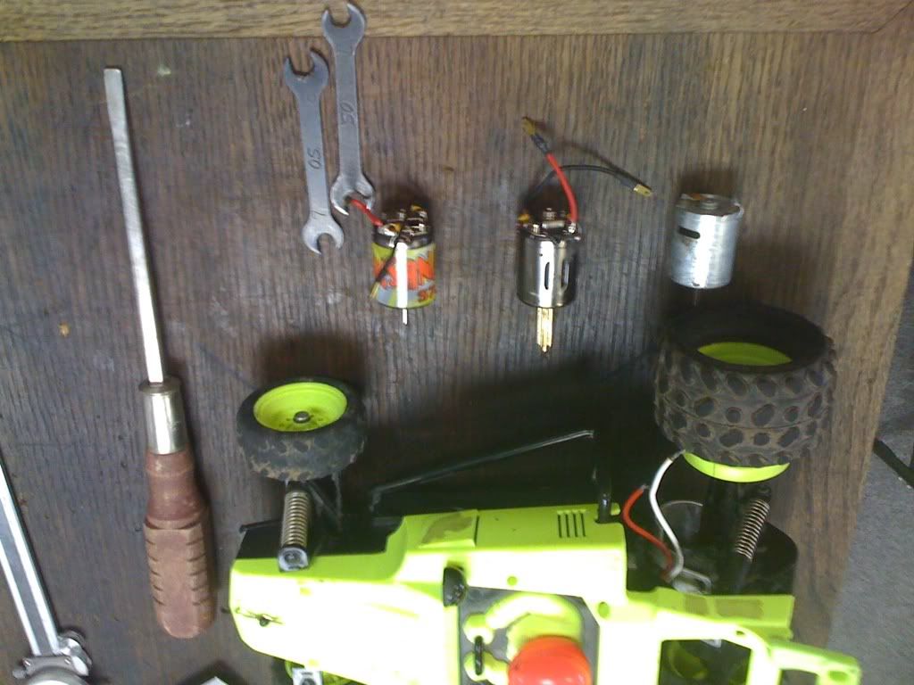

So I bought a 9.6v Wild Thing turbo hopper off ebay a few years back that is in great running shape but thats about it. The guy had used this thing pretty well and broke off anything and everything he could so as of right now its about as light as it can be
When I got it the left rear wheel was stripped out and the best way I thought to repair one was with a little trick I came up with. I dont  recommend doing this on a nice tyco but this one is a total driver so its ok and now it cant be broke, ive already tried.
I will be running to the hobby shop today to get a mod motor for it and see how it does. The goal is to try to make this as fast as it can be on the stock electronics. If I cant get it over 25mph than I will go all out and convert it over to hobby
To fix this wheel I took a dremel cutting bit and cut far enough down into the wheel to be able to fit cut-up body clips down inside. I made sure they were bent and sat flush to ensure strength then glued them in there. Yeah it looks like hell but beats the other guys method of melting the wheel to get it to hold which only burnt it and make it worse

Ok so I went to the hobby shop today and bought a little Team Losi insane 370 motor. It is a super hot modified motor and I was able to install it while I was there. I took it outside just now and in low gear its faster than it used to be in high gear lol. Its a very high winding motor and due to it pulling soo much current it overloads the speed control in high gear and wont go as fast. This means that if I convert to hobby electronics this thing will haul total ass
The thing is, with the wheels off the ground they will spin soooo fast in high gear that I wont dare let the go full power because the tires expand a ton and the axle shakes violently

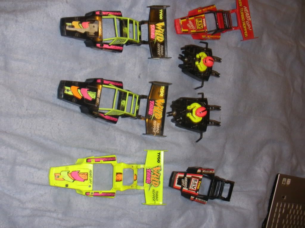

do you want a nice body for that? i have one that is lacking a cage. and some other stuff

-Hey, I had the red "Heads Up" :)

i only have the body savedone haha
