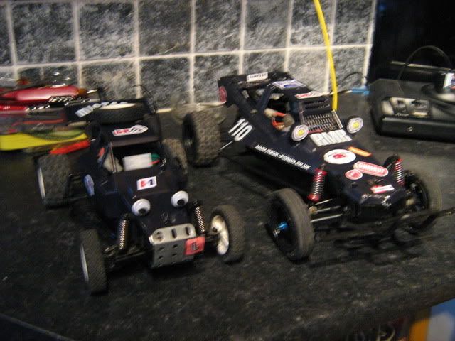

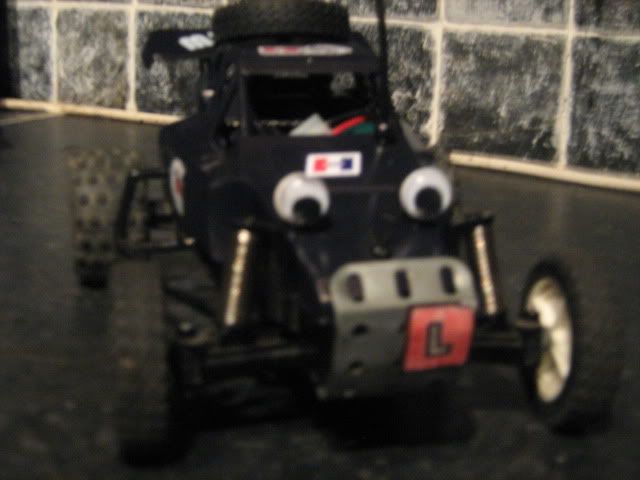

so heres the wee jet hopper ive built for my 8 year old daughter to run along side my grass hopper. got this car as a parts car was only after the shell for my shelfer. first up the hopper wasnt working due to battreys leaking and making a right mess of it so i striped everything out including the servo and fitted hobby grade radio gear on top of them i fitted a square 9.6v batt pack [ 4 aa long and 2 high. but this made the car too top heavy and caused it to tip over alot. so i striped it down again a cut and trimed the inside of the chassis so i could get a 9.6v flat pack in the bottom nice and low down with the radio gear and BEC speed control on top. this set up seems to work alot better as she hasent rolled it yet.
http://youtu.be/4X36IZCPK2g
then the body was removed a put on my shelf queen and a old body painted up to match the basher body on my 14 turn grasshopper.

Rod that's cool i have a 8 year old daughter as well and she about fell over in her chair once she saw the goggley eyes Lil nice touch, now a must for her next RC project

thanks. i cant take the credit for the lights as they where her idea. she had been watching the movie cars that morning. and said to me could we not put some eyes on the car ive got some in my art box that might fit. somtimes kids have the coolest ideas.

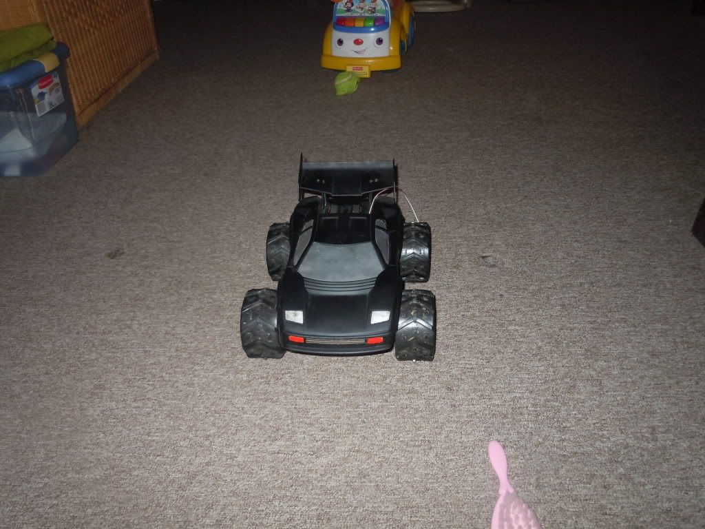

6x6 4WD Allterrain Hijacker See the Test run video
http://www.youtube.com/watch?v=Kz7Ex9c8huQ
