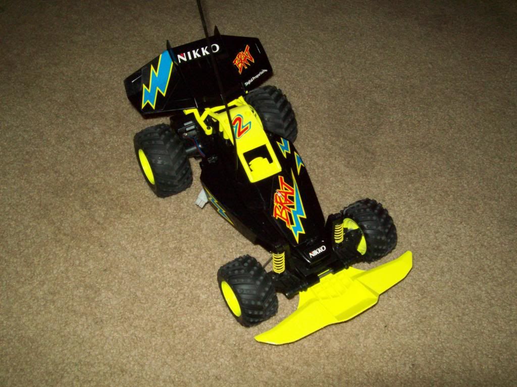

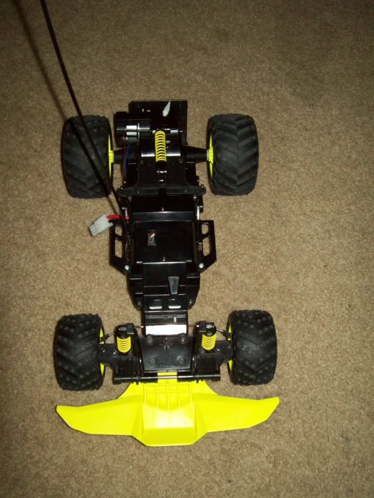

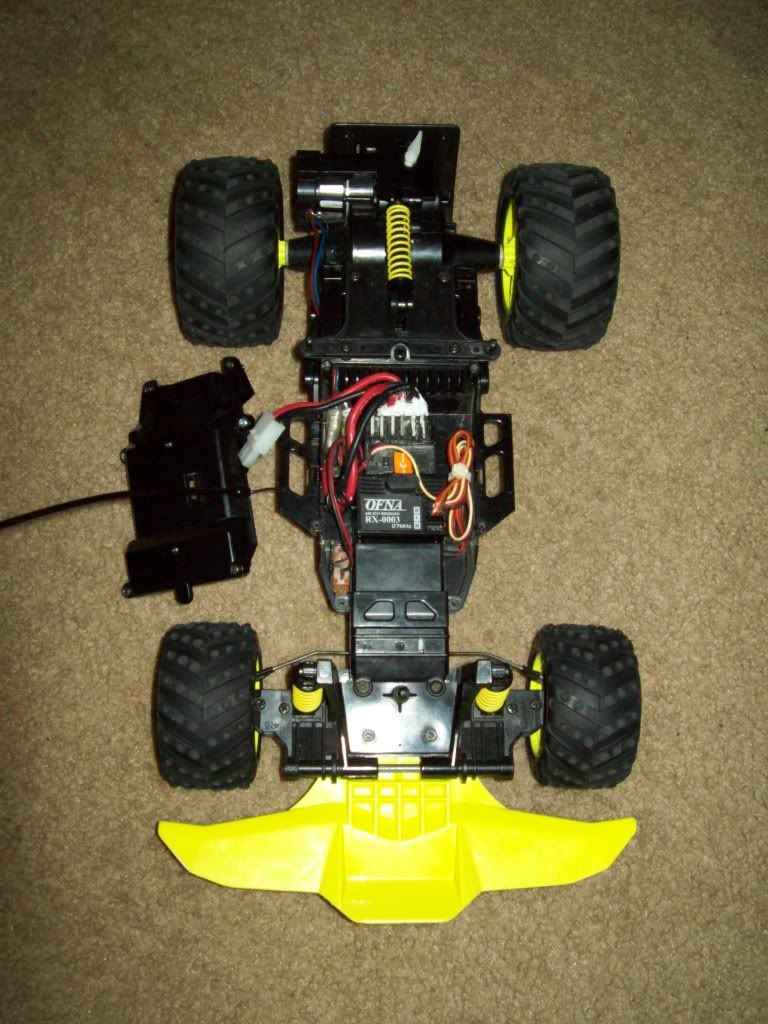

I picked this up in August for $1 @ a thrift shop. No remote & when I did find one that worked I discovered that the servo was shot. So I took some extra hobby stuff I had lying around threw it in. Runs like a champ. :)

Yeah dude, a lot of these older ones are pretty easy to mod. The servo's are virtually the same dimensions. I jus had to shave off the screw mounts from the sides.  They generally have  a decent amount of room for the other electronics as well. Good TX/RX set up is this:
http://www.hobbypartz.com/fs-g2-24ghz-radio.html
as the RX is jus stupid small. It'll fit anywhere. Plus its 2.4

Nice work on the hobby convertion. I like that you kept the power switch. Too bad the brat does'nt use the 540 motor like the larger Nikko buggies. Now that you have a real ESC, are you goinng to install a mod motor?
i didn't know a nikko chassis would accept a hobby servo
The digital proportional Nikko's use a standard 10th scale size servo, just with out the mounts (and wire plug) like Atomika had said.

what esc did you use? any chance of a video of it running? I just won one off of ebay and was wondering what esc would be compatible with the stock motor. i guess probably a traxxas lx-2.5 would work since it's for 360 size motors.

I just got an Axial AE1 for a Tyco, it can handle 9.6v. It's about the size of the one pictured above.
