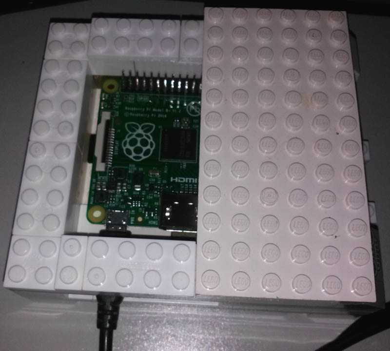

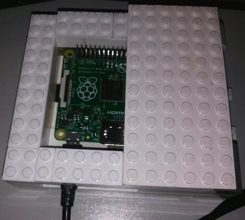

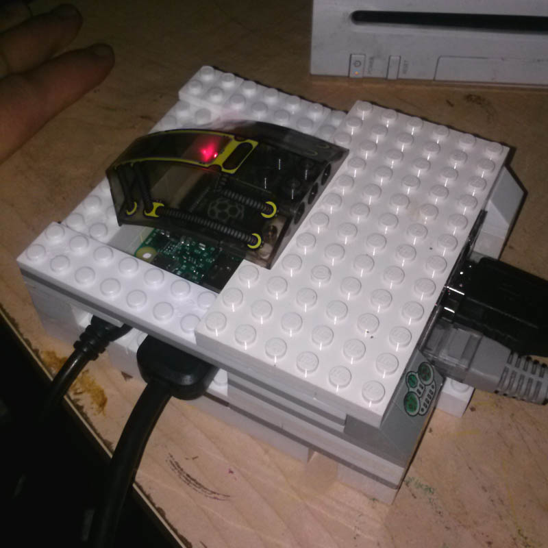

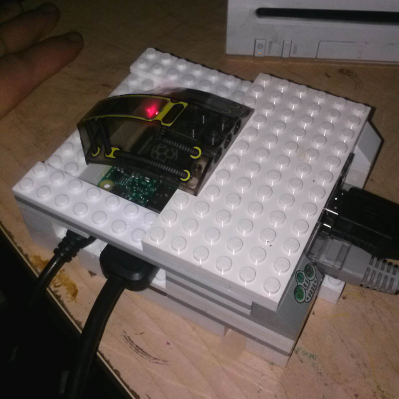

Here are a couple pictures of my home made Raspberry Pi case made of Lego blocks. After making this one I came across a website selling similar things, although I think mine is cooler looking, for around $40! Fortunately mine was just built out of blocks that my son had... which had been passed down from my youngest brother, who had received many from me. So I guess those blocks have now come around full circle.  8)
