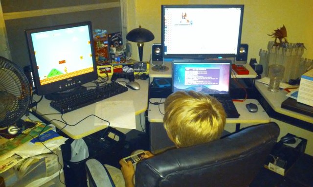

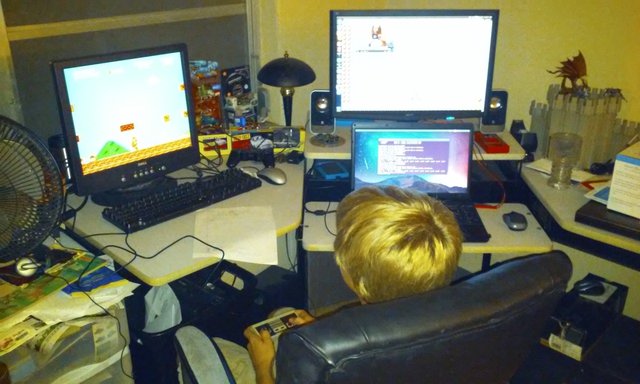

I put the controller back together and tried again... but no luck. Then I decided to take the back of the controller off and see if I could spot any problems. I used a multimeter to test out the wires that were soldered to the NES controller board and it seemed like things were working. (I'm not very experienced with the multimeter, but was at least able to confirm that I was getting a signal through the soldering jobs that I had done this time.) With the back of the NES controller off, I plugged it into my PC and ran the jstest with the same results as before... Then I tried pressing a button - WOOHOO! The program responded! I tried all the buttons! It worked just fine. So I carefully put the back of the controller back on, hooked it up to my RetroPie, configured the controller settings (with my keyboard still attached to the RPI), and was able to play Super Mario Bros.; It was a great feeling!
My son came into the room at that point, while I was playing SMB, and he was interested in checking it out, so I snapped a photo of him playing the game with my modded controller. So cool!
