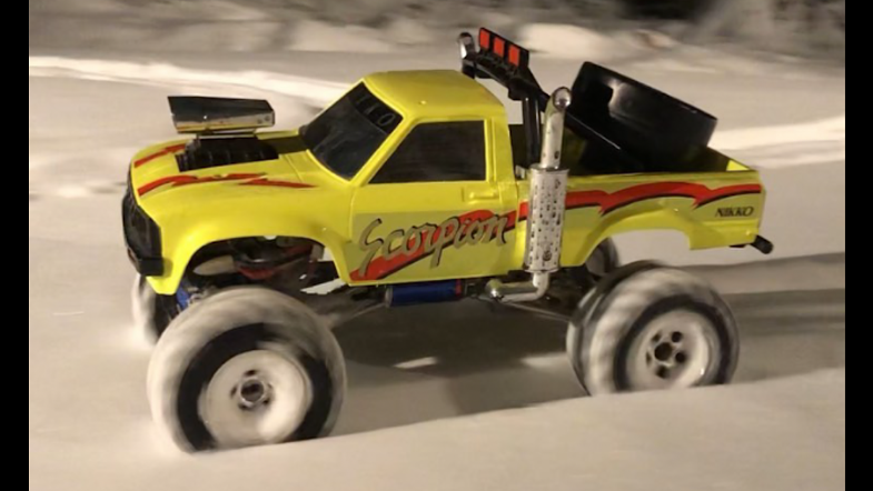

Thought I would post the most recent pic I have of the conversion I did years ago. This this is still a blast to drive

Looks neat. I assume you mean that you took the Nikko body and replaced the motor, radio, and possibly other components.
by Viper GTS on 2022-01-09 16:52:21 UTC
What I actually did was build a Losi mini pro crawler and fit the scorpion body to it. I made a mount so that it could still have the blower sticking out the hood. Then used traxxas sledgehammer wheel adapters to fit 2 sets of rear wheels so that I could use the original scorpion wheels and tires.
