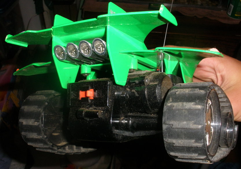

i didn't know it had a bumper! haha my back wheels look nothing like that haha. mine are bare to the bone, mine also lacked the stickers. mine is the 27 mhz version it seems like there is something wrong with the connection between remote and car. sometimes you hear the motor stops but then catches and speeds up.  nice touch with the head in the fox! haha
by notatoy on 2010-09-01 17:23:17 UTC
hi bro well it came brand new with a bumper to me lol . i have taken of some stickers fron the side of the body they looked a bit crapp lol  i dont have any problem with the motor and controller but not to sound a know it all thats toy grade electronics for you  :-\  . which is pretty much why i change them out . . though the motor does give good power  . i have just purchased another small hobby grade r/c from ebay  not sure why iam going with the small stuff cause iam a large scale guy .lol. but it does look cool . here it is will post pics when it arrives  thanks ..          http://cgi.ebay.co.uk/XTM-RAGE-4WD-BUGGY-1-18th-SCALE-READY-RUN-/320582187204?pt=UK_ToysGames_RadioControlled_JN
by czstycor/c on 2010-09-01 19:43:05 UTC

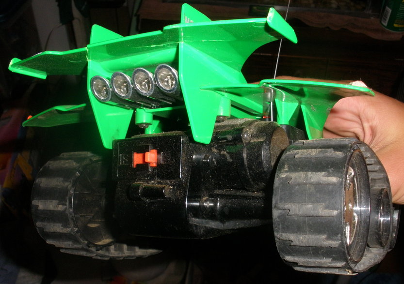

yeah i've seen stuff like that, how much is that in u.s. dollars? still i got this hot wheels buggie for $35, so since its my fastest im okay, could you however tell me how to take the wheels off and maybe give me a link for back replacement tires? if possible.

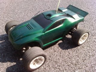

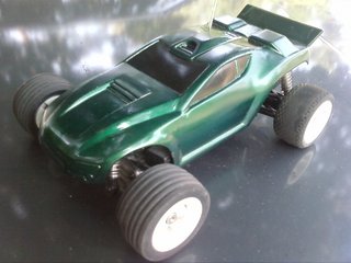

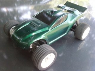

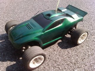

here are some pictures of the newly painted car

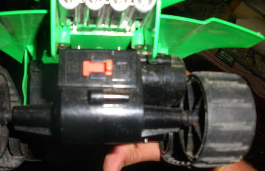

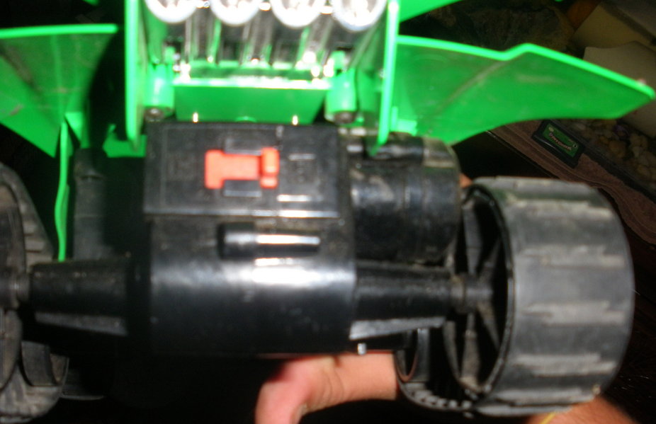

hi bro no problem to get the wheels of you will need to open the gearbox .this sounds a lot of work but its real easy just sepperate the two half;s buy taking out the screws on the  bottom then you must push the wheel down the shaft away from the compression fitting take of the gear at the end of that shaft it is a push fit and your done ,do the same for the other side then  put everything back together , you could always lube your gears and bushings while you have the gearbox open just a thought .lol.. i will check out the size of the tries today and report back  ;) ;D
by notatoy on 2010-09-02 06:42:36 UTC
OHH sorry bro the price in dollers well here is the same car brand new , bear in mind the one i just bought does have alloy upgrades ..  http://www.hobbypeoplestores.com/index.php/review/product/list/id/37108/
by notatoy on 2010-09-02 13:08:39 UTC
OK  bro i just measured the stock tires  rear only and i get  40 mm inside diameter  55 outer diameter  and the width is 30 mm . not seen any online its hard to locate because they seldom post the tire size on the web sight  your best bet is to take the wheel to your LHS and then you can try them on for size  hope this helps

by notatoy on 2010-09-04 20:47:27 UTC

by czstycor/c on 2010-09-04 22:29:00 UTC
would putting a different 370 in it make it faster? and would i need to change out the electronics
by notatoy on 2010-09-04 22:44:12 UTC
hi bro yes and no that motor will be faster than stock but should not pull enough amps to overload the stock esc  as it is the closed end bell type with none replacable brushes unlike the 280 i ordered but if  you  were to fit something like the 370 in this next link you would need new electronics  as it is whats known as a mod motor with a high amp draw ..  http://www.losi.com/Products/Features.aspx?ProdId=LOSB0837

WELL GOOD NEWS  ;D she is finished at last made and installed the body posts today and did a little tidy up  did a small test run and WOW what a difference . i have chosen low gear on the selector lever for better acceleration  not realy to botherd about top end it seems to have good speed . running on 7.4 volt  on 9.6 i would think it would be uncontrolable  . iam undecided as to weather or not to lock the differential a old rock crawler trick that gives better climbing and tourqe . any how video to follow very soon just need the rain to stop ha ha thanks  :D ;D
by notatoy on 2010-09-07 15:21:18 UTC
OK  GUYS BAD NEWS  epic fail  i was running the turbo fox to get some video when i hit  a bolder with the car ,upon till that point things were great , so after inspecting the car there was a little damage to the rear wing no big deal . so i set of again thinking nothing wrong then i heard the noise of doom gearbox  :'(  slipping . opend it up and the teeth have striped of the main gear . so i selected high gear ratio hopeing this would solve the problem . but no still the same seems the gearbox is beyonde repair . :'(. and so ends the life of the turbo fox  . on another note iam going to strip out the hobby grade motor and electronics for  hot wheels mini t look a like .so nothing will be waisted    . seen in this pic she runs a stock 280 so the losi will fit i will tranplant the servo and hobby grade esc also the reciever thanks  ..
by czstycor/c on 2010-09-07 16:17:21 UTC
so sad =[ i really need to fabricate a bumper for my hot wheels buggie. all that work on the fox haha. i was excited to see a video haha
by notatoy on 2010-09-07 17:34:51 UTC
so sad =  yes well thats the way it goes with toy car conversions  you win some you lose some great shame as it was running great i suspect that may be because of the age of it that the plastic gears were pretty weak .. never mind i have the hot wheels in pieces as we speak the losi 28 motor is fitted and the toy electronics are out will start a new thread thanks  ;D
