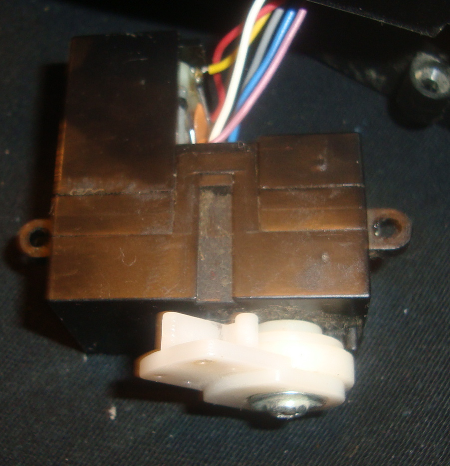

Got my old bandit out the other day. The battery was shot so ordered some new ones. Charged it up and it would only turn one way and not reset without moving the wheels by hand. So I took it apart seeing if it was a contact problem, dirt etc. Anyways I wiped the buildup off the green circuit board inside of the (part pictured below). Now the motor spins out of control as soon as you plug the battery back in. Any idea how to fix it? If not does anyone have a extra one of these parts they can sell? Will suck to rewire it but better then nothing. Wanted to play with it, with my 2 year old. She loved it going back in forth but not much fun it you can't turn ;) So any help would be great, thanks

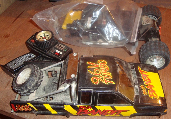

by lagalaxy8 on 2011-01-17 14:06:10 UTC
Here is a pic of it apart. It needs cleaned up bad. Was going to do it yesterday but wife wanted it off kitchen table. Since i don't have parts to fix it yet might as well wait.

Well I got a new servo and it has the same problem. Any other ideas?
by performerrpm on 2011-02-22 19:32:58 UTC
did you use the whole board/servo or only the servo? im assuming you used both? the board i sent you came from a working truck so id check the remote itself, i had one that the contacts was not making good connection when you turned, if you only tried swapping the servo, then id give the remote a try and then swap the board
by lagalaxy8 on 2011-02-22 19:40:29 UTC
I just did the servo, less wires to splice. Some of the wires on the board where coming off so I'd have to resolder quite a few to even test it. Not sure if it happened in shipping or what, but at least 3 are barly holding on.
I took the remote apart and looked it over and messed around with it, there was a groove in the copper but even if i tried to move it out of there it was no luck.
Was really hoping to just swap the part and be on the way of driving it.

The motor is going to spin intill it reaches the contact loop which completes a continuty circut. You can test this , but u have to unsolder the violet, gray, white and blue wires from the board. If i where u, i wouldnt splice anything. Just re solder a new wire. So what if people say u hacked it, thats just silly talk if it fixes the problem. I fixed my Eliminator, i wouldnt call it hacking.

by stan on 2011-05-26 01:41:04 UTC
the drive motors or the sterring servo motor spins?
if its the servo tweeking out, seems like a wire is arching creating a pulse circuit.  if theres a bed wire and its pulsaing it will cause the servo to tweek out.
if its the back motors then check around the 2 wires connected to the motors an board.  make sure theres no dust buildup making contct with the 2 wires.
also touch the radio crystal and see if it wigles. have the car on so if it is that then it you will notice it with the glitching.
