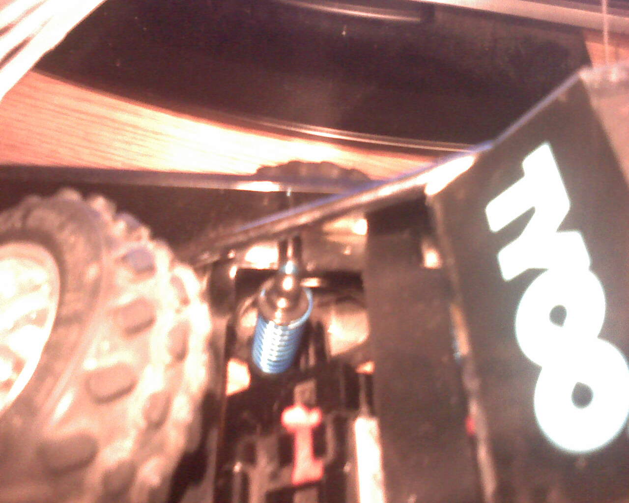

well i got my parts yesterday, pretty quick id say, anyhow the first bandit that i did the front shock conversion, now has matching oil filled rear shocks, i ordered some blue anodized shock ball studs and rear rc18 oil filled shocks, then took the tabs that the original shocks snap onto in the bed of the body and cut them off flush, then drilled into the thick area they were molded into on the bed and screwed the ball studs in, the new shocks have a ring just like the stock ones do for the bottom but you have to drill the hole out bigger to fit-its just plastic- the top of the shocks just snap onto the ball studs in the bed and actually the ball stud makes up the piece that was cut off, so when done, it looks just as if tyco put them there themselves
the only bounce now in the back is just from the tires, but otherwise it lands just as soft as any hobby grade car, and when it lands theres no clunks, just a dull faint thud.

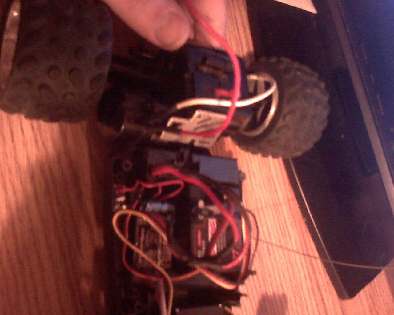

i test fit all the new elctronics and servo, everything will fit under the original cover of that originaly covered the original board, so when its done the stock antenna and light will work just like an ordinary bandit, you will not even know its been modded. itll take me a few days to finish getting it ready tho

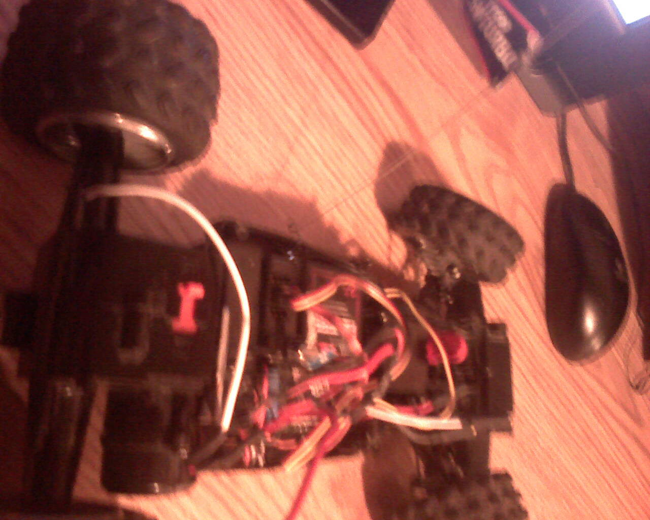

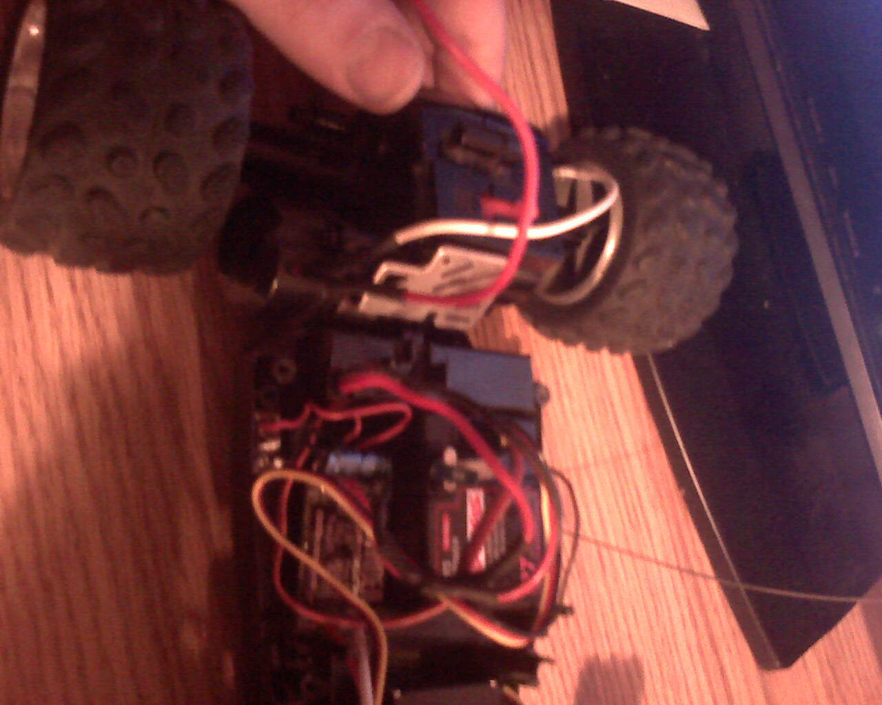

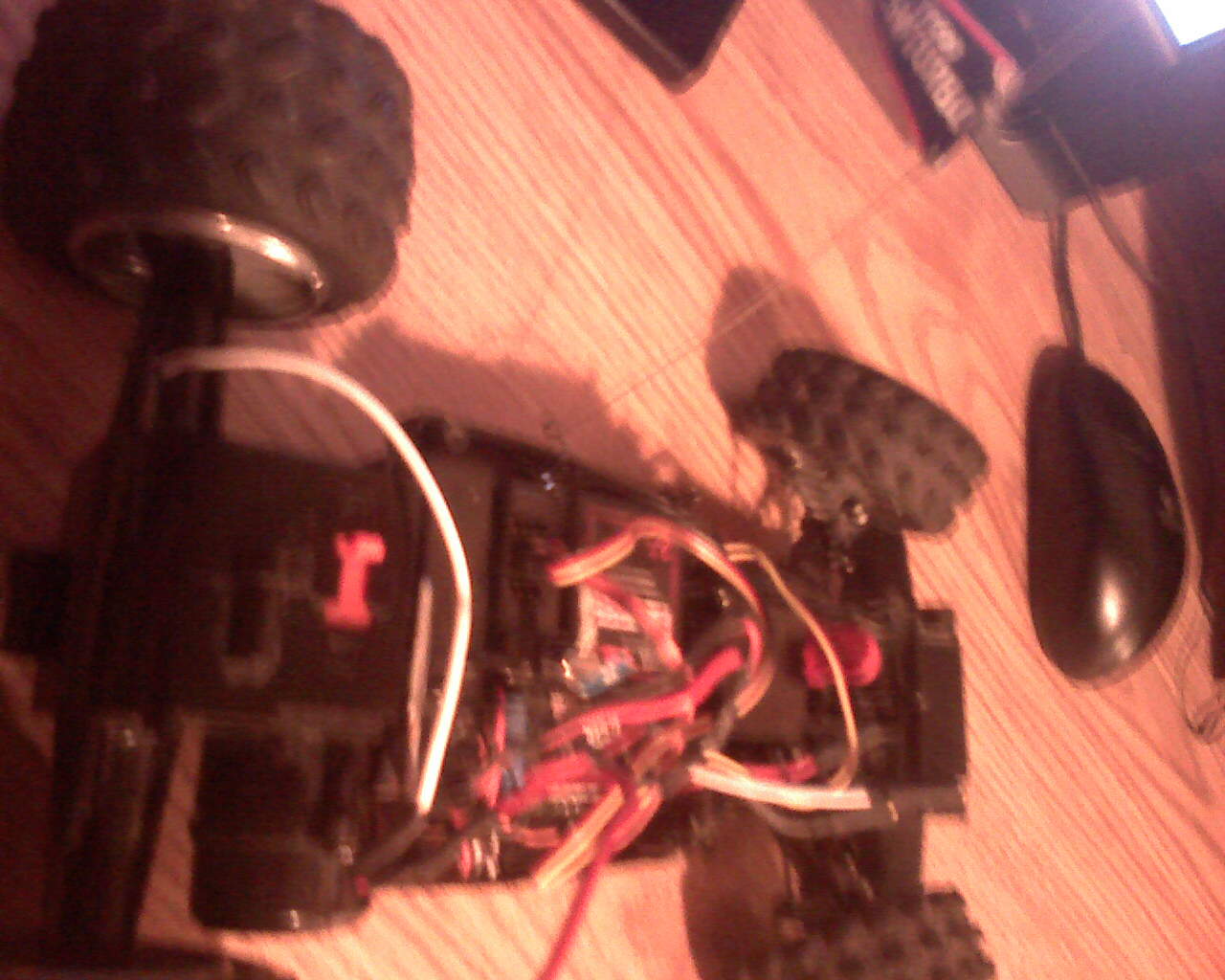

the 2 pics of the electronics is of the hobby upgraded badit usig the parts mentioned in the first post, still waiting on my castle link connector and my quick connect to get here so i can adjust the settings, the quick conect will be routed to the battery compartment for easy but hidden access, then i can change the settings whenever i want to, the insane motor is in it already, and as bandit king mentioned in his thread, the tires stayig on the wheels is gonna be an issue. the steering is connected, im leaving that red tab from the servo sticking up, so it can be turned upside down if the lower half is broken somehow. the wheels steer fine and are straight in alignment, the only issue is the servo has a small amount of over steer, i need to make some stops or just dont turn the steering nob all the way since its digital proportional, but ill probally make a stop for it. the only thing left is too put the shocks on and solder the motor wires to the esc, or get the right bullet connectors where it can be swapped out. its using the original bandit offon switch, but im gonna have to figure another way to make the red light come on with the switch, it wires different than origialy and the new esc switch wires dont seam to have enuff to get it burnin.
by performerrpm on 2011-02-28 12:49:45 UTC

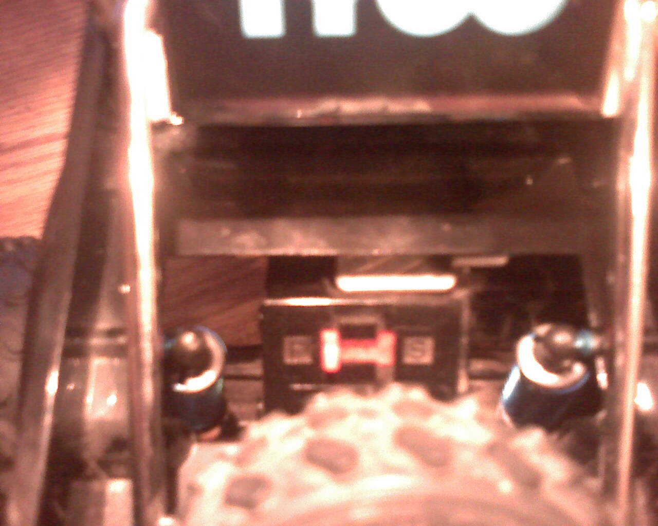

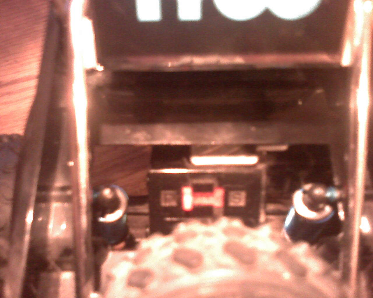

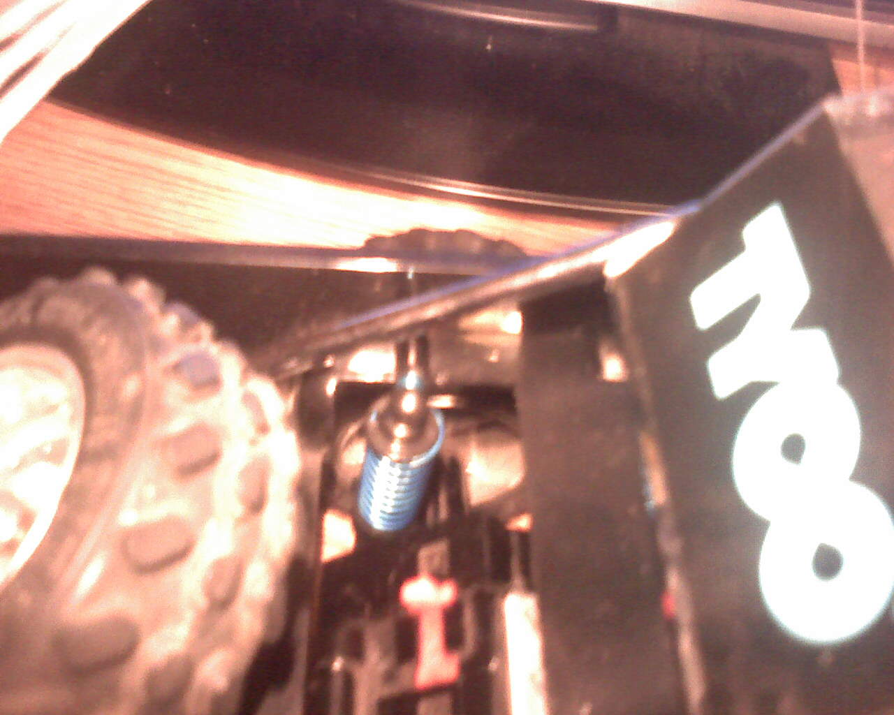

the other 2 pics are of the other bandit with stock electronics, but with both front and rear oil filled shocks, the hobby bandit is already set up for them to i just havent actually put them on yet, ill probally sell the upgraded bandit eventually to hopefully fund the hobby upgrades to the bandit i the pics with the shocks already on it, tho the one im working on now is gonna be kick azz ive already got better ideas for the next one, mainly in the servo dept and motor dept, by then hopefully there will be some metal gears around-bandit king- so it can have the brusheless motor in it, maybee the same esc tho, i like this one, it fits good, lets me use 3s lipos or ni cd or nimh upto 14-15 volts i forgot the exact amount, in any case the one pictured is using a 9.6v nimh pack.
also for the next one im planning on getting the rxtx from wanna of the rc that have lights that can be turned off/on at the remote and run off the battery pack power, may even do it to this first one, but not sure yet
