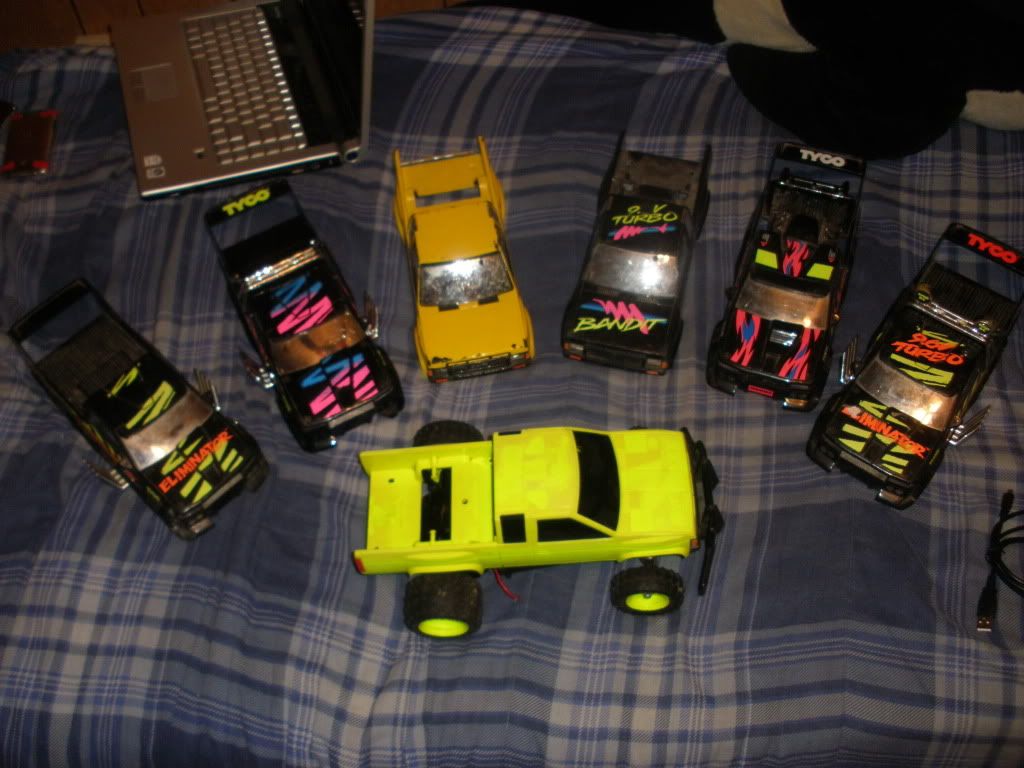

sweet, i want it to look something like this when i'm done, like a full sized outlaw. but i do have all those other bodies to choose form

here i put the chrome shield in off an extra body i have. i think it would need chrome rims then
i thought this looked cool
Re: My project Yellow Bandit
« Reply #7 on: December 13, 2011, 23:28:46 »
yeah agreed the black looks better,,,,and wow now thats a bandit wild thing !!!!,,,they should have put that into production
