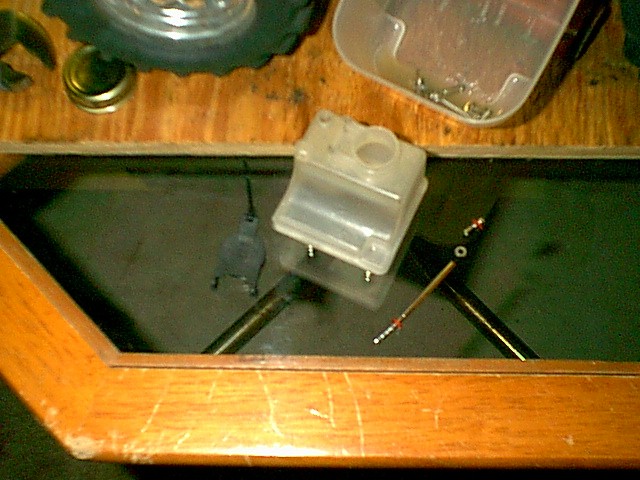

Here
it is - my modified fuel tank. Hopefully this will take care of my fuel problem.
Based on the instructions at MaxxTraxx, pulling the primer out was a little more difficult than I was expecting. Finally I gave it a good hard yank and it came out for me to clip. Since I was using an old pair of wire cutters I had to get some assistance from my pliers so that I could squeeze down with both hands to clip the primer.
After I got the primer out I used some Seal-All (since it is resistant to gas and oil) on the bottom of the o-ring, and again after putting in the 4mm x 6mm screw. I've let it set overnight and today I'll be putting it back onto my T-Maxx to see the results.
